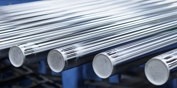

We supply tubes, bars, and both ingot-cast and continuously cast steel. For tubes, we produce hot-rolled dimensions from 55 up to 250 mm outer diameter, and cold-rolled from 30 to 100 mm. Cold-rolled offers finer tolerances and a higher degree of material reduction, dimensionally more precise, though at a higher price point than hot-rolled. On the bar side, typical applications include couplings, drill bits, and shank adapters. Our steel is used across the full drill string, from top hammer shank adaptors and drill rods to DTH casings and bits, through to hydraulic breakers and grinding media.

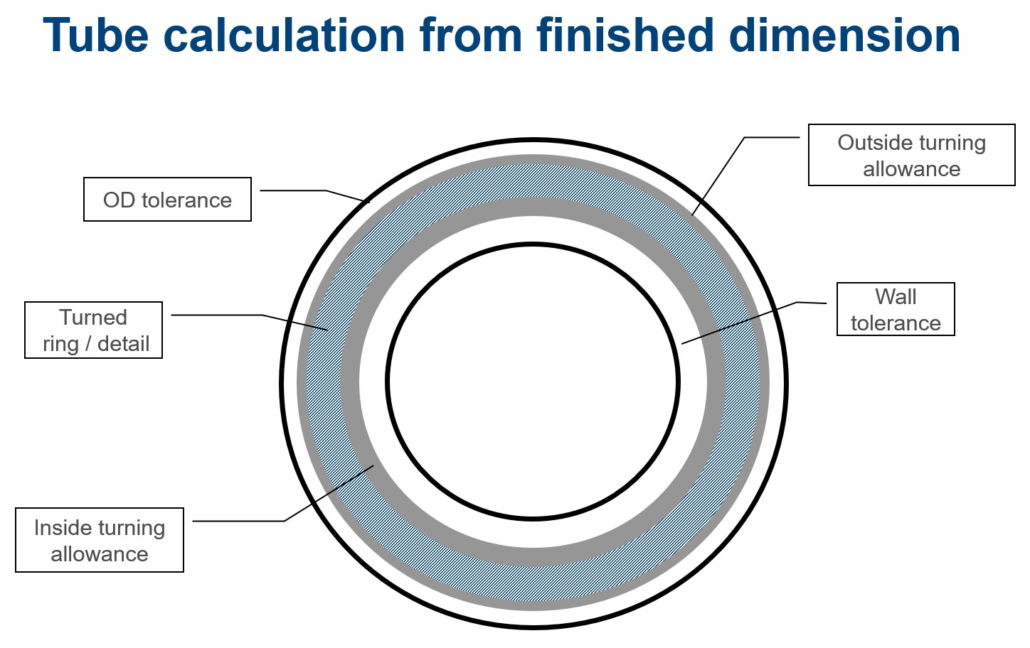

This is something we are passionate about, and an area where we add value that is not always visible to customers yet. The standard approach is that a customer requests a delivery dimension, we supply it, and they machine it to their finished size. What we want to do instead is start from the other end: tell us your final machined dimension, and we will calculate the optimal near net shape tube or bar to get you there.
For grades, a common steel grade in mining is 42CrMo4, a well-established quenched and tempered grade, and our own 495B, a specialized mining grade developed for various applications in the mining segment. One example is the casing tube for the DTH-hammer.
The practical result is that less material machined away means shorter production time, less scrap to handle, lower material costs, and reduced CO₂. One important technical detail is that we also need to understand the first machining operation, whether the part is chucked from the inside or outside, because that determines how we calculate the allowances.
