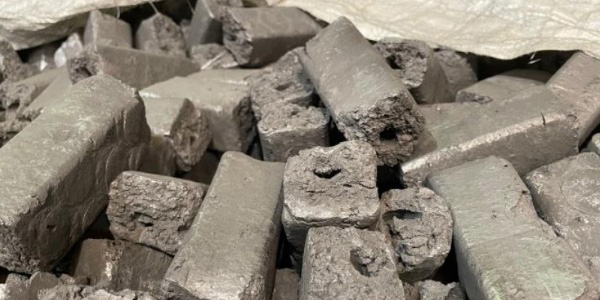

Biochar is not a straightforward drop-in replacement. Anyone working in steel production will tell you that the physical properties matter as much as the chemistry. Biochar is significantly lighter and more reactive than fossil coal. It behaves differently in the furnace, burns more readily, and requires careful handling to avoid losses before it even reaches the melt.
To make it workable, the material needs to be reshaped. That typically means compressing it into briquettes or chunks so that it can be transported safely, stored, and introduced into the process in a controlled way. From there, it can be added to the scrap buckets before melting, injected through a lancing system into the liquid steel, or used in the slag foaming process that protects the electrodes.
